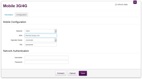

Configure the mobile internet connection
  1. Browse to the Technicolor TG589 router GUI.
  2. Click the Mobile 3G/4G card header
  3. The Mobile 3G/4G page appears. Click the Configuration tab.
  4. Under Mobile Configuration, update the following fields if necessary:
    APN:
    Enter the Access Point Name (APN) of your service provider.
    Operator Mode:
    We recommend you to use the default setting, Automatic (let the TG589 router choose the best operator mode), unless your service provider instructed you to select another mode.
    PIN:
    The PIN code of your SIM card.
    This information should be provided by your service provider
  5. Under Network Authentication, provide the username and password provided by your service provider.
    If your service provider did not provide a user name and password, then leave the Username and Password box empty. In this case authentication is not required.
  6. Choose Save and then select Connect.
  7. The mobile connection is now up, but will not be used for internet access unless your main internet connection goes down. Your main connection is always the preferred connection to the internet.
