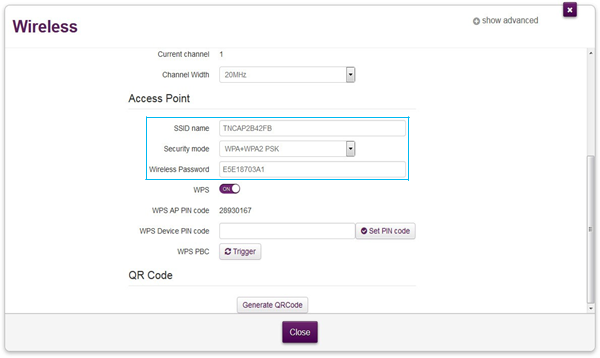

Forgot your wireless key?
If you’ve changed the wireless settings manually and you don’t remember your settings, try one of the following:
  1. Use a computer that is already connected to your network.
    If none of your computers is connected to the wireless network, connect one with an Ethernet cable.
  2. Browse to the web interface.
  3. Click Wireless. The Wireless page appears.
  4. On the left menu, select the access point that you want to view.
  5. Under Access Point, you can find the network name (SSID) and wireless key (password)
