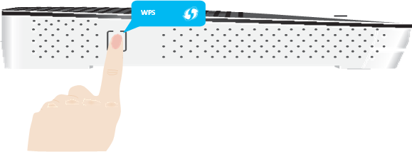

  1. Briefly press the WPS button on your Technicolor TG589 router.
  2. The WPS LED starts blinking orange. This indicates that your router is now searching for wireless clients that are in registration mode. You now have two minutes to start WPS on your wireless client.
