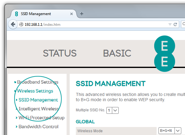

  5. Select BASIC

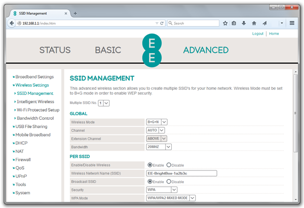

  6. Select Wireless Settings, and then SSID Management in the left menu
  7. The SSID MANAGEMENT page will open

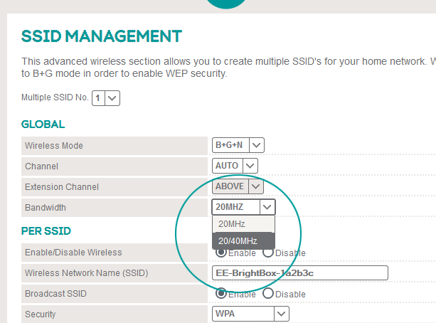

  8. From the Bandwidth menu, select 20/40MHz

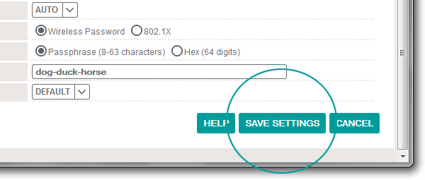

  9. Click SAVE SETTINGS
  10. Your new settings will be applied
