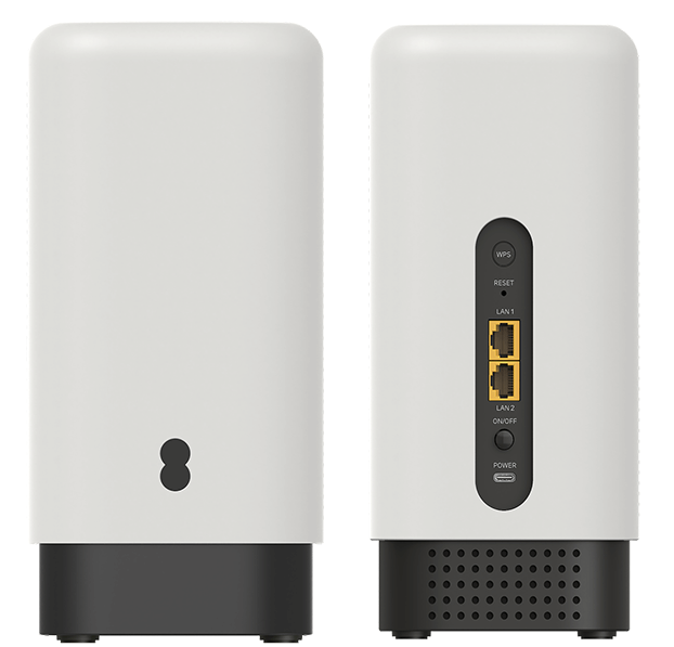

Set up your Mobile WiFi Extender 7 Pro
Wireless Setup
Turn on your Mobile WiFi Extender 7 Pro
  • plug your Mobile WiFi Extender 7 Pro into a socket near your hub
  • switch on the extender and wait for the light to flash red
Pair with your Hub
  • Press the WPS button on your hub, then within two minutes press the WPS button on the back of your extender.
  • Pairing may take a few minutes. When the hub and extender have paired, the light on the front of the extender will be solid aqua.
Where to place your Mobile WiFi Extender 7 Pro
  • Unplug the extender from the wall (it'll retain your setup) and place it in a good location.
    A good location is indicated by a solid aqua light on the extender after it’s been plugged back in.
Wired setup
Plug your Mobile WiFi Extender 7 Pro into your hub
  • Plug one end of the white ethernet cable we’ve supplied into one of the yellow LAN ports on the back of the Mobile WiFi Extender 7 Pro.
  • Plug the other end into a spare yellow LAN or yellow LAN/WAN port on the hub. Ensure your hub is turned on.
Wait for a solid aqua light
  • Turn on the Mobile WiFi Extender 7 Pro. After a few minutes, the light on the front of the extender should turn solid aqua, indicating it has successfully paired with the hub.
    • Unplug the extender from the wall and remove the ethernet cable.
    • Find a suitable location in your home. A solid aqua light on the extender indicates a good location after it’s been plugged back in.
    Positioning your Mobile WiFi Extender 7 Pro
    Try positioning your Mobile WiFi Extender 7 Pro halfway between your hub and the area with poor WiFi. A solid aqua light indicates a good signal.
    If the light is orange, try moving the extender to a different location.
    What the lights on your Mobile WiFi Extender 7 Pro show
    Flashing Green. Your device is starting up.
    Flashing Blue. You’ve activated WPS to connect to your Hub, a wireless device, or extender. Connect within 120 seconds.
    Blue. Your Mobile WiFi Extender 7 Pro has successfully connected. Once it turns Aqua, you’re ready to go.
    Aqua. Your Mobile WiFi Extender 7 has a successful connection and a strong signal over WiFi or ethernet.
    Orange. Your Extender is connected, but the signal is poor. Try moving it closer to your hub or another extender.
    Flashing Red. Your extender is not connected to your hub. Follow the instructions in the guide to set up your extender. You can also reset it to factory settings by pressing the reset button on the end of a paper clip for five seconds.
    Red. Turn your extender off and on again. If the light still doesn’t turn aqua, use the end of a paper clip to press the extender reset button for five seconds to reset to factory settings.

    Resetting your Mobile WiFi Extender 7 Pro to factory defaults
    If you’re having issues, factory resetting your device by pressing the reset button on the back for five seconds may solve the problem.
    After factory resetting the extender, you must pair it with your hub again.
