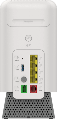

Rear view of the EE Smart Hub Pro 7 showing all the available ports
Description of each port follows listed from left to right when looking at the back of the Hub).
Connectors, ports and buttons on the rear of the Smart Hub 7 Pro
Centre of back panel
image of the hub pointing to the location of WPS button in the middle of the rear panelWireless (WPS) button – connecting devices wirelessly
Lower left-hand side, top to bottom
Small pinhole buttonReset button: reset to factory default settings
An upright  rectangular connector . Standard USB A shapeUSB port for charging devices
Power button – to turn on/off
A rectangle upright connector. Standard connector shape for landline phonePhone port – connects a landline phone to Digital Home Phone service
Lower right-hand side top to bottom
A vertical block of 4 ethernet ports, with latch to the rightEthernet (4 ports) – connects to your devices
A rectangle connector. Standard Ethernet shape, with latch to the rightWAN – connect to Openreach modem

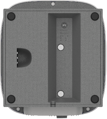

WiFi Settings Card - pull-out the card to find your Hub’s default WiFi name and password on the reverse
The base of the product with a rectangular recess and circular socket at one end. The power supply cable plugs into itPower connector
