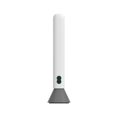

About the Smart Hub 7 Plus
Smart Hub 7 Plus - Image of front of the Hub
Smart Hub 7 Plus

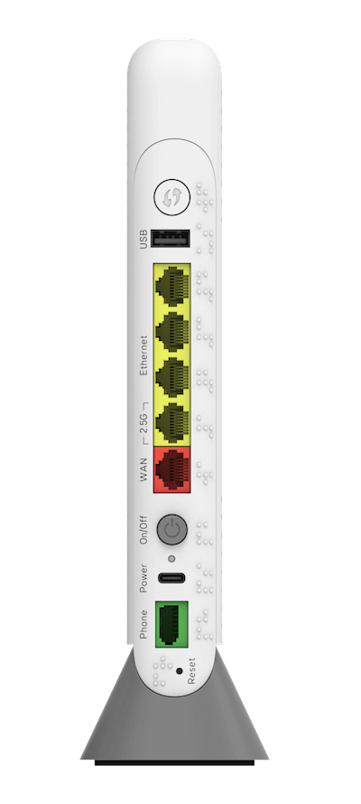

Physical description of device
Image of back of the Hub zoomed-in on the ports/connectors. Description of each port follows listed from top to bottom  when looking at the back of the Hub) Braille is positioned to the right of the sockets, except for the Reset button at the bottom of the panel where Braille is on the right.
Connectors, ports and buttons on the rear of the Smart Hub Plus
Round push button used to connect devices wirelessly using WPSWireless (WPS) button – connecting devices wirelessly
USB port used for charging devicesUSB port for charging devices
Four Ethernet ports for connecting devices using a cableEthernet (4 ports) – connects to your devices
WAN port used to connect to the Openreach modemWAN – connect to Openreach modem
Round push button. Flush means the hub is on. Protruding means the hub is off.Power button – to turn on/off
Power connector for the mains cablePower connector
Phone port for connecting a landline phonePhone port – connects a landline phone to Digital Home Phone service
Small pinhole reset button used to restore factory settingsReset button: reset to factory default settings
