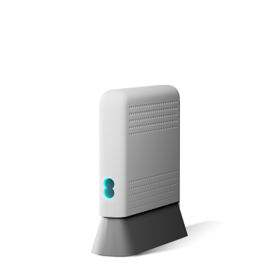

WiFi Extender 7 Plus - Image of front of the Hub

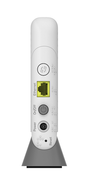

Image of back of the WiFi Extender zoomed-in on the ports/connectors. Description of each port follows listed from top to bottom when looking at the back of the WiFi device. Braille is to the right of the sockets and buttons, except for the reset button which is to the left
Connectors, ports and buttons on the rear of the WiFi Extender 7 Plus.
Round push buttonWireless (WPS) button – connecting devices wirelessly
An ethernet port, latch to the leftEthernet port – connects to your devices
Power button – to turn on/off
A small round socket. The power supply cable plugs into itPower connector
Small pinhole buttonReset button: reset to factory default settings
