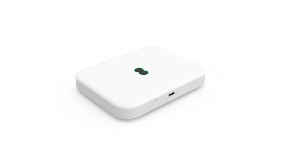

Physical description of device
Image of 5G Wifi device with location of USB-C port, power button
