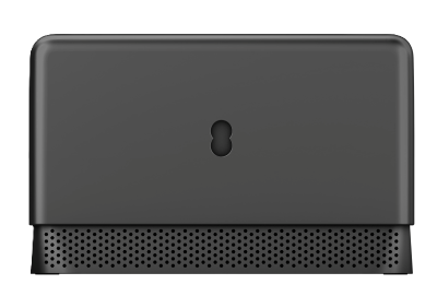

Image of EE Smart Hub, remove protection sleeve before setting up.
EE Smart Hub
What's in the box
image of Hub. Remove protection sleeve before setting upYour EE Smart Hub

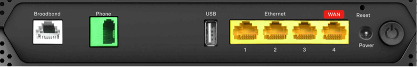

Physical description of device
EE Smart Hub rear panel: connectors, power and reset
Connectors, ports and buttons on the rear of the EE Smart Hub
Other
a square connectorBroadband
a rectangle upright connector. Standard connector shape for landline phonePhone port - connects a landline phone to Digital Home Phone service
a rectangle upright connector. Standard USB-A shapeUSB port - not used
a rectangle connector. Standard ethernet shapeEthernet (4 ports) – connects to your devices
Small pinhole buttonReset button - reset to factory default settings
a small round hole. The power supply cable plugs into itPower connector
Power button – to turn on/off
A recessed round button on the left-hand side of the hubWireless (WPS) button - connecting devices wirelessly
A rectangular plastic card that slides out of the back of the hubWiFi Settings Card: Pull-out the card to find your hub’s default WiFi name and password on the reverse.
