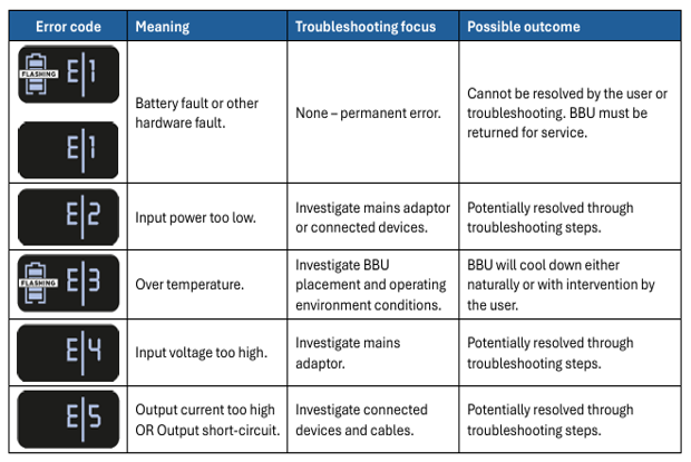

Error Codes
If your Battery Backup Unit (BBU) displays an error code, use the table below to see what the code means and the checks you can carry out.
