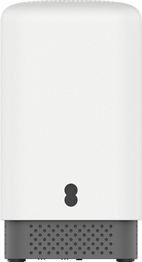

Smart 5G Hub 7 Plus - Image of front of the Hub
Smart 5G Hub 7 Plus
What's in the box
front of the Smart 5G Hub 7 PlusYour Smart 5G Hub 7 Plus

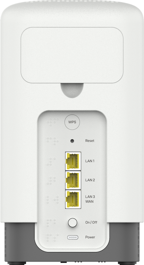

Physical description of the Smart 5G Hub 7 Plus
Image of back of the hub zoomed-in on the ports/connectors. Description of each port follows listed from top to bottom  when looking at the back of the Hub) Braille is positioned to the right of the sockets, except for the Reset button at the bottom of the panel where Braille is on the right.
Connectors, ports and buttons on the rear of the Smart 5G Hub 7 Plus
Round push buttonWPS button – to initiate pairing with Hub
Small pinhole buttonReset button - to reset to factory default settings
A vertical block of 3 Ethernet ports
Ethernet WAN/LAN – to connect to your devices
Round push button
Power button – to turn on/off
A small rectangular shaped horizontal hole. The power supply cable plugs into it.USB Power Connector - the power supply cable plugs into it
