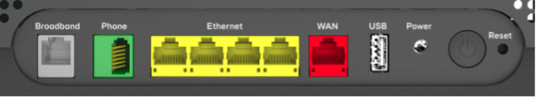

Image of back of the hub, zoomed-in on the ports and connectors. Description of each port follows, listed from right to left when looking at the back of the hub.
Rear panel: connectors, power and reset
Connectors, ports and buttons on the rear of the Smart Hub Plus
Small pinhole button
Reset button: reset to factory default settings
Power button - to turn on/off
A small round hole. The power supply cable plugs into itPower connector
a rectangular upright connector. Standard USB-A shapeUSB port: not used yet
A rectangle connector. Standard ethernet shapeWAN port: connect to Openreach modem
a block of 4 ethernet portsEthernet ports - connects to your devices
Standard phone port shapePhone port - connects to Digital Home Phones
A square port for the broadband cable for part-fibre connectionsBroadband port: this port may not be present if you have a Full Fibre connection
