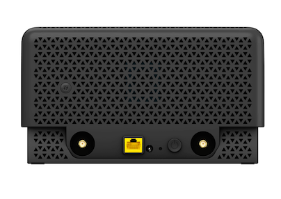

Image of back of the Connectivity Backup device zoomed-in on the ports/connectors. Description of each port follows
Connectors, ports and buttons on the rear of the Connectivity Backup

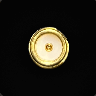

Round screw type connector
Antenna port – Optional for antenna to be connected

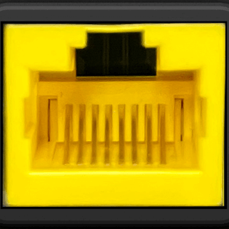

1 single ethernet port
Ethernet (1 port) – For optional wired connection to Smart Hub

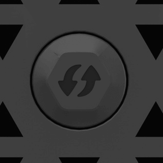

Small pinhole button
Reset button: reset to factory default settings

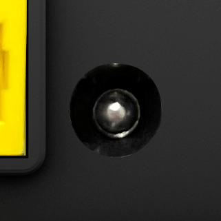

A small round hole. The power supply cable plugs into it
Power connector

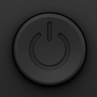

Round push button
Power button – to turn on/off

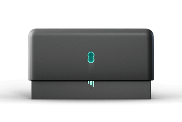

Error states are displayed through the lights on the front of the device:
EE logo light
  • Solid green: Your device is starting up.
  • Solid orange: Your device is too far from your hub.
  • Solid aqua: Your device is paired with your hub.
  • Solid red: There’s a problem, please restart your device. If it’s still red, get in touch.
  • Flashing green: Your Connectivity Backup device is not paired with your Smart Hub. Make sure the hub’s on and attached to your device.
  • Flashing red: Your device cannot connect to your hub. Try connecting with an ethernet cable or moving it closer.
  • Flashing aqua: Your device is pairing with the hub.
4G Signal bars
  • Flashing aqua: Your device is connecting to the mobile network.
  • Solid aqua: Your device has a strong signal. Two or three bars are good.
  • Partially aqua: One bar is ok but you may be able to improve it. Follow the instructions on this page.
  • Solid white: Your device is using mobile data to support your broadband. Two or three bars are good.
  • Partially white: One bar is ok but you may be able to improve it. Follow the instructions on this page.
  • Solid red: There’s a problem with your device. We’d like to help, so please get in touch..
