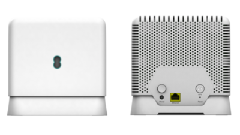

Front image of the EE Smart WiFi Plus
  • Green - your device is starting up. It takes roughly a minute to fully turn on.
  • Aqua - your WiFi Extender is all connected. Good WiFi or an ethernet connection.
  • Orange - WiFi Extender 7 Pro is working okay. Try moving it closer to the hub or one of the other WiFi Extender 7 Pro devices.
  • Red - there’s a problem. Turn your Smart Hub and WiFi Extender 7 Pro device off and on again. If the light still doesn’t turn aqua, press the WiFi Extender 'factory reset' button with a paper clip or pen.
  • Flashing orange - your WiFi Extender 7 Pro is not connected to your Smart Hub. Connect using WPS or ethernet cable.
  • Flashing blue - the WiFi Extender 7 Pro device is connecting. WPS is on and connecting to your hub or device, this could take a couple of minutes.
