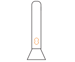

Orange light
A solid orange light means your hub isn't connected to the internet.
Restart your hub
  1. Turn your hub off using the Power button on the back of the hub.
  2. Wait for two minutes.
  3. Turn it back on.
Check your activation date
If you're new to EE or have recently moved home check your broadband line activation date has passed.
Check for service issues
Check for any issues that might cause problems with your service.
Check your broadband
Need to know
If your service hasn't been activated yet, for example you've moved house or there's a problem with your service, you could set up a Connectivity Backup.

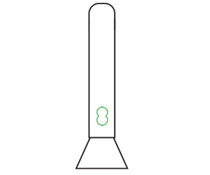

Green light
A green light means your hub is starting up. Wait at least three minutes for it to turn solid aqua.
If it stays green, restart your hub.
  3. Turn it back on.
  4. Wait three minutes for the hub to restart and connect to broadband and then check the lights again
Smart Hub showing On/Off switch and power cable connected to wall socket
If the light is still green after this, reset the hub.
  1. Use a pin, straightened paperclip or similar object to press your hub's Reset button while your hub is switched on.
  2. Hold the Reset button for around 20 seconds until the light turns green again.
  3. Release the Reset button, wait for the hub to start up and then check the lights.

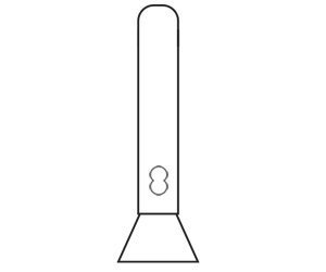

No light
If the hub light isn't on, either the power is off, or you've turned the light off.
Is the hub plugged in and switched on?
  1. Check the power cable is plugged into the socket in the back of your hub.
  2. Check your hub is connected to the power socket and that it's turned on.
  3. Push the hub's Power button to check if the lights now come on.
Has the light been turned off using the EE app?
It's possible to turn the light off on your hub.
You can manage the settings for your Hub in the EE app.
