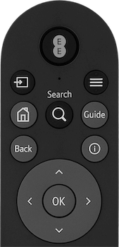

TV Box Remote Control
Image of buttons on a remote control
For details on the TV Box Pro remote control and its functions, find out more in our interactive guide.
