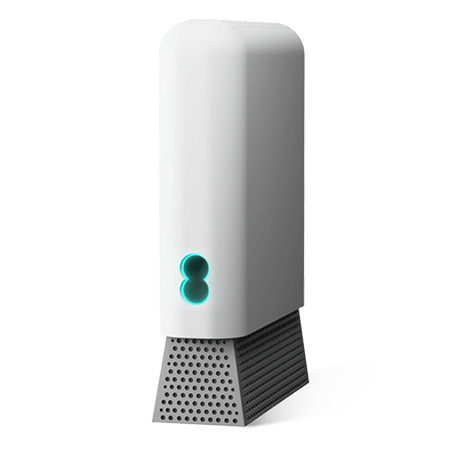

image of EE Smart WiFi Pro
The WiFi Extender 7 Pro device extends the WiFi range around your home and is ideal for large homes, older properties, and those with WiFi dead spots.

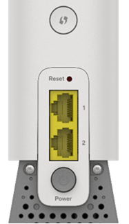

Image of the rear of the Smart WiFi Pro, showing the power connector, Ethernet ports, reset button and status light.
Underneath the device
Connectors, ports and buttons on the rear of the WiFi Extender 7 Pro
Round push buttonWireless (WPS) button – connecting devices wirelessly
Small pinhole buttonReset button: reset to factory default settings
Vertical block of two Ethernet portsEthernet (2 ports) – connects to your devices.
Power buttonPower button – to turn on/off
Rectangular recess with a round power socketUnderneath the device - power connector
