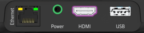

Rear panel: connectors and power
Back of EE TV box showing the connector ports
Connectors, ports and buttons on the rear of the TV Box Edge
Top left
a small round hole. The power supply cable plugs into itPower connector (green)
a rectangle connector. Standard Ethernet shapeEthernet (yellow) – if not using Wi-Fi, connect to your Hub using the cable provided
a flat, wide rectangle connector with bottom corners slightly angled. Standard HDMI shapeHDMI (purple) – connect to your TV using the cable provided
a rectangle connector. Standard USB shapeUSB – use for connecting some accessibility devices, for example, a keyboard

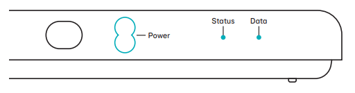

Lights on your TV Box Edge
Diagram of the front of the EE TV Edge box showing where the lights are
 Power
light
Status
light
Data
Light
Box onAquaOffOff
Box, in standby modeOffOffOff
